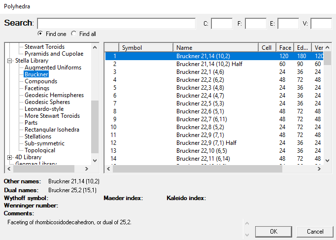

If you have Great Stella or Stella4D, then they can be found in the library, in the Bruckner folder:

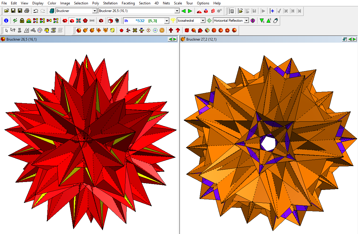

And since Stella shows you the dual as well, and nobles are all duals of other nobles, you get two at once:
