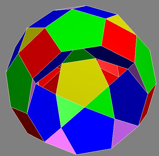

I found a new interesting equal-edged torus today by excavating two J92's out of an icosidodecahedron
ID-J92 Torus.jpg (56.76 KiB) Viewed 79259 times
Has anyone ever made this before?
I never read Stewart's toroid book, maybe it's in there?
Posts: 732
Re: New Torus
Nice. I'm not familiar with it offhand. It's not immediately obvious that J92 should reach exactly halfway into the icosidodecahedron. Interesting.

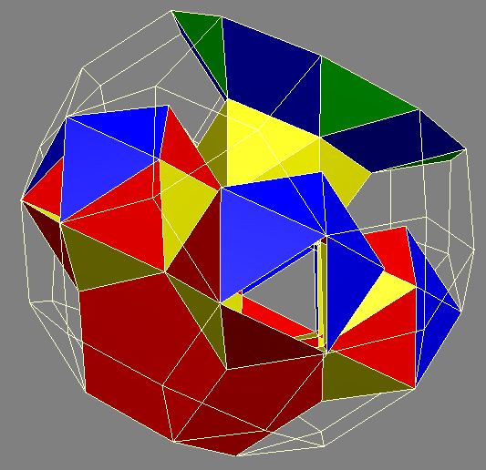

I found another interesting one yesterday:
J32 Torus.JPG (30.31 KiB) Viewed 78986 times
This is a J91+J63 Tunnel through a J32 (Pentagonal Orthocupolarontunda)
I realized then that J32 had a cross section of 2 of those irregular hexagons that Stewart talked about inside a Rhombicosidodecahedron.

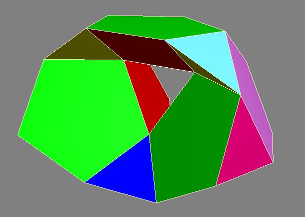

So I created a new toroid that has Stewart's quasi-convex property that doesn't seem to be mentioned in his book (I only have first edition, though):
J76 Torus.JPG (44.46 KiB) Viewed 78983 times
This is J76 with a rotunda and two icosahedra removed for a genus of 2.
Posts: 732
Re: New Torus
That one's nice. Seems unexpected that the icosahedron should align like that.

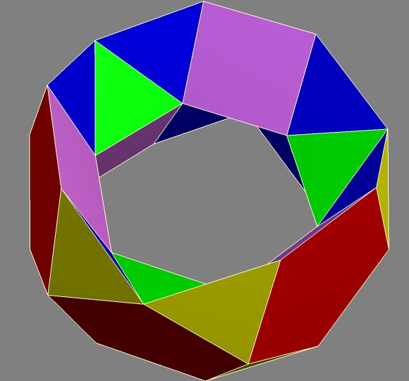

Even better, I got one with a genus of 6 and retaining the original symmetry of J76 by cutting through with a Dodecahedron and 5 J11s
J76 Genus 6.JPG (46 KiB) Viewed 78981 times
Still quasi-convex!
Posts: 732
Re: New Torus
Yep very nice. J76 minus a dodecahedron and 5 diminished icosahedra.

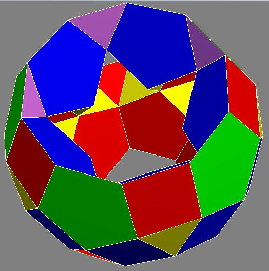

And an alternate version with antiprism and cupola replacing rotunda:
J76 Genus 6 alt.JPG (57.53 KiB) Viewed 78980 times
