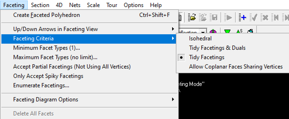

No the faceting criteria are not related to the stellation criteria at all. It's all specific to faceting. It finds all possible facets, and then enumerates valid combinations of them.
The available criteria can be see in the menu below. I think "tidy" facetings may have been your term?
For the dodecahedron, I get the following results:
- Tidy Facetings - 24 facetings, which includes 1 chiral and one compound of two chiral halves
- Tidy Facetings and Duals - 22 facetings, which includes 1 chiral and one compound of two chiral halves
