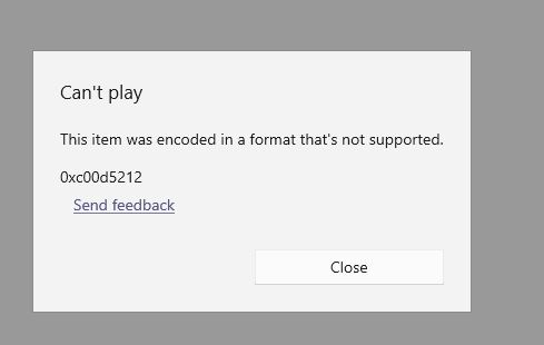

Re: Unable to export tour as video
Thank you Robert for your assistance.
It did not work out. I have attached files for you to see which kind of procedure I do. I export it and it has extension /avi, but it does not play. I tried with VCL and movies&tv in Microsoft.

- Posts: 747
I just tried exporting an uncompressed AVI and I was able to play it with VLC. It gave an error: "Unidentified codec:
VLC could not identify the audio or video codec", but still played it anyway. The error may have been because there was no audio stream?
If memory serves, I think at some point Windows stopped including AVI codecs by default, so you may have to download and install them separately in order to play AVIs properly. But I think VLC has its own codecs so it should still be able to play them anyway.
So I'm not sure what to suggest. If anyone else is reading this, I'd be interested to hear whether you can play AVIs exported from Stella.
You might also want to try using a more standard video size, such as 1920x1080. Some video codecs only support certain sizes. You could also try using a program like Handbrake to convert the AVI to another format, but this will only work if Handbrake is able to read the video, which it may not if even VLC isn't working. Or you could export as a series of separate images and use another program to convert them to a video (not sure if Handbrake might do that for you).
A future version of Stella will export videos differently and support a much wider range of formats. AVI is no longer the standard it once was. But that will likely be quite a while off.

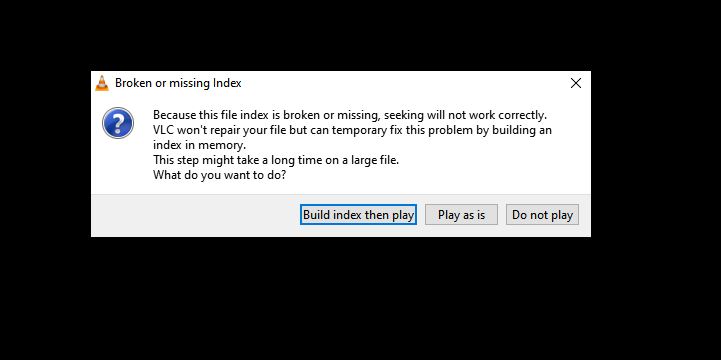

Txs Robert.
This is what I get from Vlc.
When updated version of Stella will come out, that will be able to export tours?
Cheers!

- Posts: 747
Hi again,
So I think what happened is that when Windows 10 came out, it no longer included codecs for many video formats, and Stella relied on those to create videos. Microsoft basically broke their own APIs retrospectively.
You can download codec packs though, and that should bring back the functionality. You could try the following for example:
https://www.codecguide.com/download_kl.htm
After installing the codecs, you'd have to export them from Stella again, because I think the issue is the rendering not the playback. I'm surprised it doesn't report an error when rendering though.
Let me know if this helps. I'll add something to the FAQ if it does.
